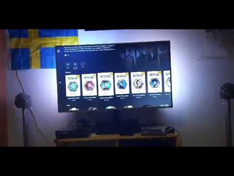

I wanted to watch some doctor who on plex when this happened:
Now, this happens every time and on nearly all episodes as far as I can tell. With an exeption for some extras apparantly. Can anyone help me figure out what is wrong with these files? I have no problem with any other series or movie so I don’t know why this is so. :disappointed_relieved:
