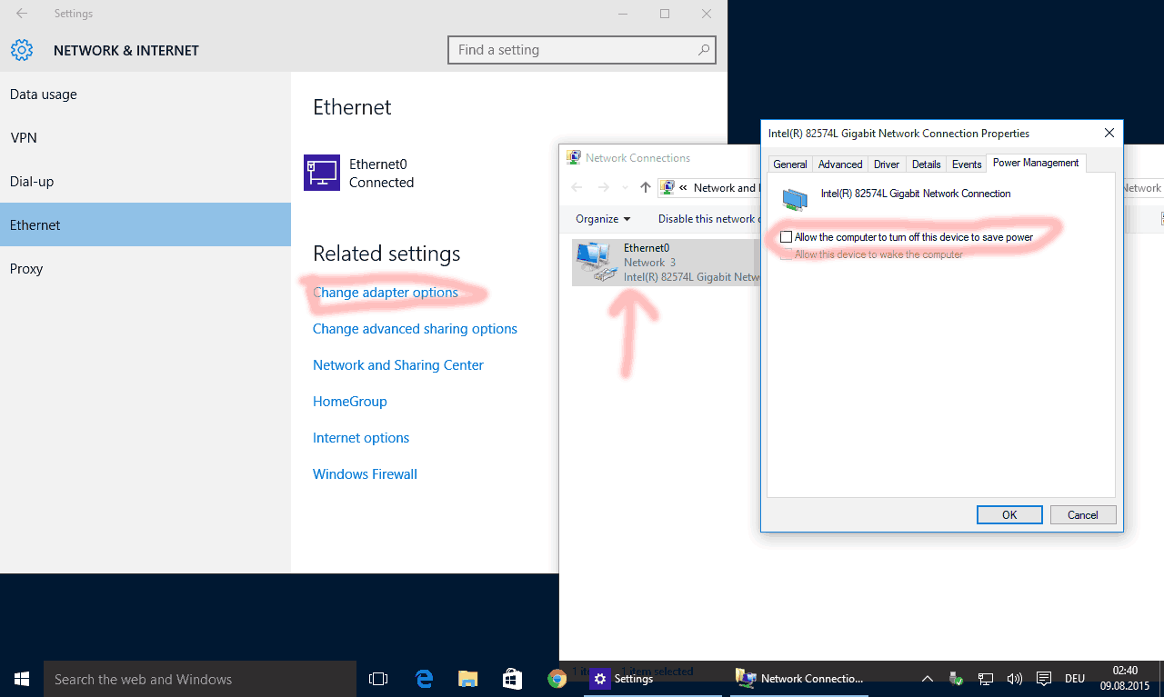

in any way, go to the energy settings in the properties of the network adapter(s) and disable energy saving
Most crucial on the server, but I’ve seen cases where the client needed this setting too.
The Server is wired. The laptop on which I’m trying to play is wireless. I’ve changed the power setting with no change. Still continually buffers.
