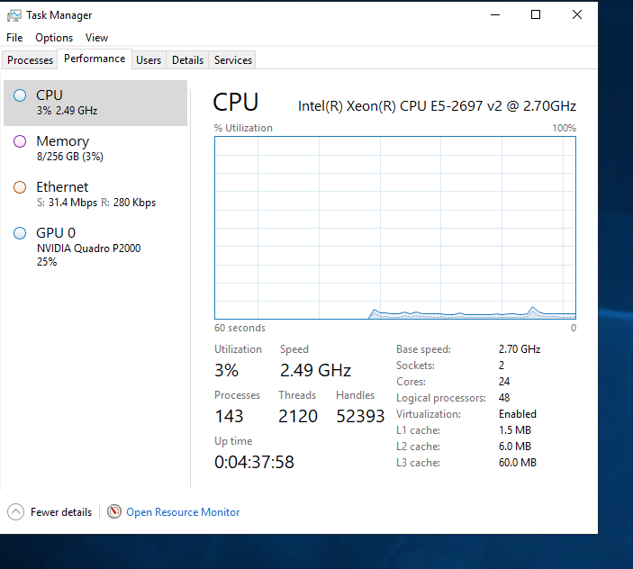

SERVER: Dual Xeon E5-2470 v2, 128GB RAM, Nvidia P2000 (also tried a RTX 2070), fresh Windows 10 Pro install, no other codec packages installed, latest Nvidia driver, and all the settings enabled correctly in PMS to have it do HW transcoding. Transcoder settings: Quality (Automatic, but I’ve tried them all), Temp Directory (SSD drive), Buffer (90), Use HW acceleration when available (checked), Use HW accelerated encoding (checked), Max simultaneous transcode (10).
THE ISSUE: HW transcoding works perfectly for 1080p h264 & h265. Movie starts playing right away, task manager shows GPU using 10-12% for both encoding & decoding, and Tautulli shows transcoding at 2-3x playback speed depending on the bitrate. However, when I play ANY 4K HEVC content, regardless of bitrate, it takes a while to start playing - anywhere from 30 seconds to a minute - at which point it shows HW transcoding is working, but the GPU is only being utilized 7-9% for both decoding and encoding, Tautulli shows a transcode speed of only 0.6-0.8x, and the movie obviously buffers endlessly.
