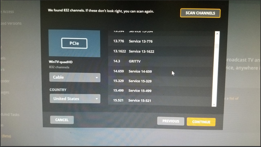

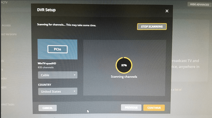

My problem is that the Scan finds 835 QAM channels, but Plex “disregards” 3 for some weird reason and I have attached two pictures to show the Scan at 97% and then the after result. Most of the 800+ channels are encrypted, which I don’t care, I have a prime that handles those via NextPVR…for the moment, depending on how this goes as I don’t have very many tagged copy-once). I know exactly which channels are missing and you can see it in the second picture, which only shows one 14.3. The Scan magically makes 14.1, 14.2 and 14.4 disappear for no apparent reason. I really don’t watch channel 14.1 (FIOS QAM WFDC-DT HD version), but that channel was the only one in the QAM viable range that aired US vs Mexico earlier this month (we tied them in their home of Azteca!!). I found the SD version of that same channel by enabling one channel at a time and picking a mapped channel at random, since it is the only way to be able to tune to that channel via live tv (I am using a mi Box android TV box). Do you guys know how long it took me to go over that many channels, for which Plex did not find a match? A really…really long time, but I hate giving up, but I am about to do it as I feel this is a show stopper for me. I did not want to go back to SageTV even if I hate change.
