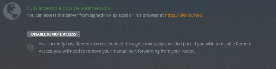

capture 1 shows remote access screenshot after I switched to IPv4 only in windows.

worked with google wifi team to resolve the problem. Now, I am able to connect to plex via my xbox and remotely using cell signals. However I still get the error message depicted.![] Is this a problem?(/uploads/default/original/3X/9/0/903f297215ab1529f2ee8b05a70d76d70c0a0b1c.png “”)
