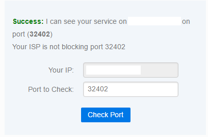

If you goto www.canyouseeme.org and enter port 32400 what results do you get?
For my server I set it to 32402 for this screenshot and this is the results from there:
