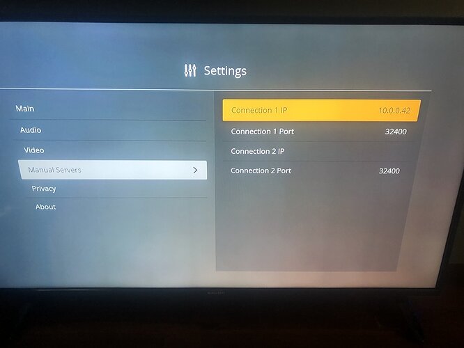

Can you share a screenshot of what you’re seeing on screen, please? As well as any associated settings. :slight_smile:
It’s probably worth noting that when I first set this network up I had the same issue until I added the settings seen in the screenshot above. And when the issue presented itself again today I checked these settings and they had reset itself, I changed the settings back to what you see above, but this time it didn’t fix the problem.
Can you read the server at 10.0.0.42:32400 and log in there using a browser?
Does the server require a secure connection, or prefer it?
From a web browser on my phone. My phone has no issue connecting to Plex from the app though.
RE: Secure connections requirement, that’s hard to determine. I can’t really connect to Plex from a computer at the moment since the server is on an isolated network. To connect to the server I need to login but to login I need to be connected to the internet, and seeming as my computer can’t be connected to both the internet and the Plex server at the same time it doesn’t work. I had so much difficulty trying to connect my computer I was usprised my phone and Xbox actually worked to date.
