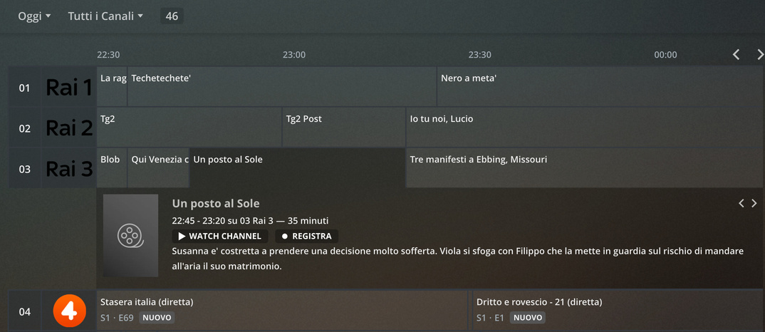

After the upgrade of the server the TV guide showed on all devices is shifted of an hour later. Checking the xml file the time is correct.
Here an example where Plex show it at 21:45 and on the xml file is at 20:45
<programme start="20200910204500 +0000" stop="20200910212000 +0000" channel="03">
    <title lang="it">Un posto al Sole</title>
    <desc lang="it">Susanna e' costretta a prendere una decisione molto sofferta. Viola si sfoga con Filippo che la mette in guardia sul rischio di mandare all'aria il suo matrimonio.</desc>
    <category lang="it">Intrattenimento</category>
Your XML data shows the time zone as +0000 (GMT). Based on the language of the guide, I assume you’re in Italy? If so, shouldn’t the time zone be +0200 (GMT+2)? Since the image in the Plex guide shows a start time of 22:45, it looks like it lines up.
Yes, it is correct and I’ve noticed now that the time zone is not correct. I’m using web grab plus for grab sky TV guide and seems that there is something wrong.
Do you know if in web grab plus that setting can be done in the webgrab++config file or it is needed to modify the ini file?
Sorry, I’m not familiar with Web Grab Plus, you’ll have to check to see if they have any documentation which addresses this. Or perhaps someone else on the forums here knows more about that service.
