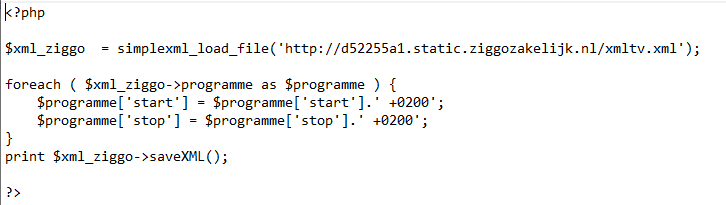

I found a simple solution to resolve the time shift using a php script also referred to as ’ simplexml.php’. The script content is as follows:
The +0200 ensures a timeshift of 2 hrs. Change this entry to meet your need.
I installed this script on my synology ( with php package installed). In DSM Taskplanner I created a task that runs the above script every day once and stores the output in a external reachable location.
This is the command in DSM Taskplanner:
php -f /volume1/web/tv/simplexml.php > /volume1/web/tv/ziggo.xml
The PMS reads the XML via the url https://mydomain/tv/ziggo.xml
Works great!
