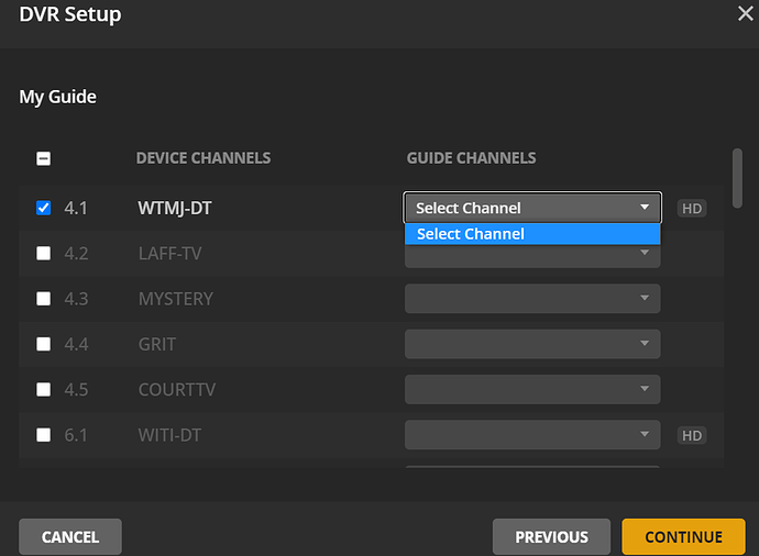

I can’t setup an alternative TV guide because it won’t map the Guide channels.
This is caused by the error:

can you run the xml file through some XML validator to see what particular aspect is malformed?
It is valid:
$ xmllint --noout tv_guide_data.xml && echo ok || echo problem
ok
What are you using to get the XMLTV data? I had that issue using EPG123, not including the channel number fixed the issue. To get the channel numbers and combine a couple of services I use xTeve and pass that to Plex.
I’m using:
XMLTV module version 0.5.70 in Ubuntu
I’ve attempted to use these two grabbers unsuccessfully
tv_grab_na_dd
tv_grab_zz_sdjson
Sorry but I am not well versed in Linux. But see if you have a configuration option not to include the channel numbers and see if it will work then. I had to do this in order to import the data from Schedules Direct.
