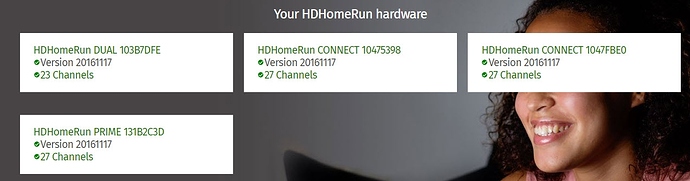

Prior versions were better at utilizing available tuners. Starting with one of the 1.7.x releases I started seeing issues with multiple recordings. If I had 2 scheduled recordings everything was fine both tuners of one of my Connects would be used. If I had a third recording it would fail. I have another Connect, a Dual, and a Prime all configured in DVR. None of the other devices had recordings, nor were they being used by other applications. Plex would basically report that no tuners were available. I have since reverted back to 1.6.1 and can record more than 2 recordings at the same time again.

All of my tuners have the most recent (non Beta) version of the firmware.
I am able to get all of the tuners to work concurrently using Plex version 1.6.1. Something in the 1.7 series of releases seems to have broken the ability for multiple tuners to be utilized by Plex DVR.

Ah, it seems that 1.7.x is the culprit, then? When I last reported this, I was running 1.7.1. I downgraded to 1.6.1 and didn’t bother testing with that version. Upgraded to 1.7.5 and ran the test again. LCD is the 1.7.x release. As a software developer, I can see ‘collateral damage’, ie., sections of code not related to the latest fixes that are now not working. But this is not a piece of coding off in a seldom-used corner of the app. Finding an available tuner is somewhat mainstream for a DVR-like application. Yes, beta. No, not tested against the rails. Perhaps a full regression test is needed for every major release. Just my opinion – not to be construed as fact.
I’m using Firmware version 20170612beta1 on the HDHomeRun Prime that is configured with Plex DVR. This firmware upgrade fixed an issue whereby scheduled recordings would drop at 6 min and 6 seconds (6:06).
