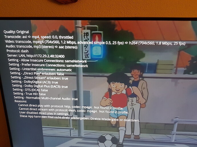

Hello, I have a problem with my new Samsung TV (2020) and the Plex Player.
It works so far but I have the problem that I have older programs from 1978 or 1990 that I no longer have a 16: 9 format on the device. Nothing was changed on the Plex Media Server. I have previously had a Samsung SmartTV where this could be changed using the green button, but apparently this is no longer possible. Is there a solution for this? with the newer broadcasts you can see everything normally in 1080 P and 4 K. But the problems arise with older series, for example. I have included a screenshot.
My Plex server is running on an Ubuntu 20.04 LTS server.

Screenhots:

I don’t think I understand. You want your letterbox shows stretched? If it’s a transcode thing, your included photo says that direct play was user disabled, so you should check your server settings.
Frank
Yes, it doesn’t matter whether direct play is on or off. I’ve already tested that. The server settings are also not because it works on my old Samsung TV that doesn’t have Tizen OS. He still has the old remote control where you have the buttons A = red, B = green, C = yellow and D = blue. When I pressed the green button there came a menu where I could resize. Now I have a similar button combination via Tizen OS but unfortunately nothing happens within Plex - no menu comes up regardless of whether I press A, B, C or D.
Unfortunately, I can’t say whether it’s the device or the Plex, but I haven’t installed any new server software on the Plex. And as already mentioned, it makes no difference whether I go to the public version or switch to the test version - it makes no difference. I have set in the menu of the TV that it should resize 4: 3 to 16: 9 but this function is grayed out when I am in the Plex so that it is not supported.
