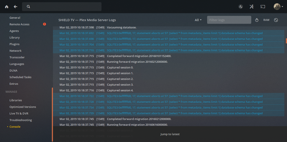

No longer getting 404 errors but guide update fails with SQL Lite errors:
I’m glad I saw this now. I have been having the same issue for a while now (to the point where I had to ditch Plex and get a cable box to keep the wife happy). I thought maybe it was just my setup so I tried to troubleshoot the issue for a while.
