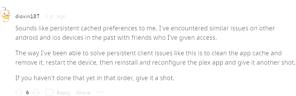

if your settings are actually correct and you are still having that issue, you can try this from reddit.
  1. Streaming quality and remote streaming quality both are set to maximum. Although I am streaming it locally only.
  2. Already cleared the cache and reinstalled the plex android TV app.
  3. Like I mentioned in my post, 4K videos are not getting played if I play thru Sony TV, but if I connect “Chromecast with google TV” to the same TV 4K videos play perfectly.

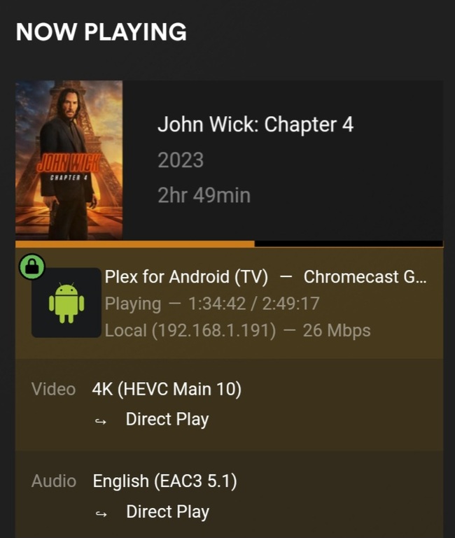

When Connected “Chromecast with google tv” to Sony TV and played via plex app from “Chromecast with google tv”. No transcoding is happening. Sony TV model is x75l 4K UHD
