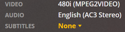

So these files i am looking at have never gone through Handbrake. These are straight non re-encoded files. This is what the info in Plex says: -
I don’t think you can get any more 576p than that. The Plex Info section correctly reports what it is. However the pre-play screen shows this: -
So do think there might be a bit of a disconnect between what the Info section thinks the video is, and what the pre-play screen says it is.

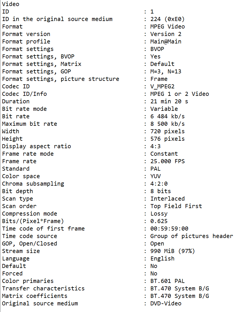

FWIW here is what Mediainfo thinks it is: -
It does affect one of my remote users who uses a Chromecast via an iPad. It shows as being transcoded to 480p when played. This is reported by both Plex and Tautulli. Other than that most of my users see it upconverted to 720p. I play back locally on a shield and it is direct play.
That looks to me like a perfectly normal PAL 576p item.
All set to display at 4:3.
I don’t understand about the up-coding to 720p.
The MPEG-2 bit will mean it’ll transcode on some things, but why 480? What’s wrong with 576?

Maybe it’s because Plex reports it as a 480 interlaced video in the pre-play screen. So it converts it to a progressive 480 video to work with the i-pad and/or chromecast. It sounds similar to the problem I had a couple of years ago with the Roku, where transcoding was based on the reported resolution in the pre-play screen, not necessarily the actual resolution or bitrate.
Yes, of course that’s the reason… don’t know how that one got by me…
If it was reporting 576 it might transcode same (ideally).
