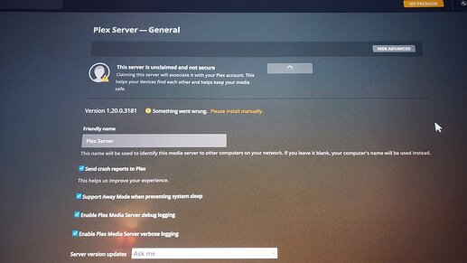

I’ve enjoyed a Plex Server almost a year now, however since about 4 days ago, I started noticing Metadata for new entries failing. Then after a random system reboot, I got the “server unclaimed” error, and attempting to claim it just spins and times out.
I’ve read a lot about this, tried solutions I could find to no avail. I’ve Uninstalled, cleaned registry of all “Plex, Inc” instances, reinstalled… nothing. Finally I went as far as to destroy months of work spent editing posters and my own metadata updates etc by deleting my “Plex Media Server”… and STILL this software setup manages to FIND A SERVER THAT ISNT THERE, and its UNCLAIMABLE!!!
I’m really at my wits end. I even tried deleting my old account and creating a new one from a different email address… still a server that can’t be claimed. I’ve tried on Chrome, Chrome incognito AND Microsoft Edge browsers. I have a backup I made a few weeks ago of my Windows, but I REALLY don’t want to risk going to that extreme - my 100GB plex database folder is gone anyway.
There HAS to be a simpler solution to this. Can someone please help?? Thank you

Here’s my most recent log and a photo of what I really don’t want to see anymore:
Plex Media Server.log (320.8 KB)
You switched on verbose logging, please don’t, and you still have some kinda network issue

OK here’s what I just tried, just after my fourth attempt at the cleanest possible install (without reinstalling windows). Between the time I snapped the first and second photo, a message appeared “Sorry this server can’t be claimed”. (or to that effect..)
This is my 64,000 dollar question: WHAT server??? There IS no Plex server on my machine!!! I’ve AGAIN uninstalled using a brute-force (Your Uninstaller), AND using regedit I cleared all traces of “Plex, Inc.”, AND made sure both “C:/Program Files (x86)/Plex” and “C:\Users\Paul\AppData\Local\Plex Media Server” were DELETED.
So where is this “server”? If I can get around this, and am able to create a NEW server, I’ll bet it will in fact be reachable, and claimable. I’m directly connected to my base router still, and NO OTHER software on my machine has ‘network issues’.
Are there references that “Your Uninstaller” and myself aren’t seeing in the registry OUTSIDE of the “Plex, Inc.” entries?? Or again, is this something to do with “tokens” and or my Plex account??

If there is no server installed on the machine why are you trying to claim it. What else were you expecting to do?
You restarted the server and provided a log from that server after I asked you for it. The server in your first screenshot was called Plex Server.
The screen you just posted is the first run set up screen for a server called PaulPC. You could not get to that screen unless a server was installed and running. based on your log it appears to be installed on a computer with Local IP 192.168.0.107
