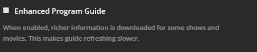

Okay this a request/am i missing something question :smile: . Please correct my assumptions here if i am incorrect. When you record something the metadata it pulls is Gracenote EPG metadata. This if you select “Enhanced Program Guide” it instead relies upon the initial gracenote information to match to thetvdb.com for their more detailed information. But here there be dragons.
When I was setting up my server to use tv dvr i chose the “Enhanced Program Data” because it was “enhanced” and of course I would choose it :smile: The problem becomes that I mostly use my dvr for PBS kids shows and as many of you know PBS shows follow no rules for naming and numbering. For example we have this show Daniel Tiger.
