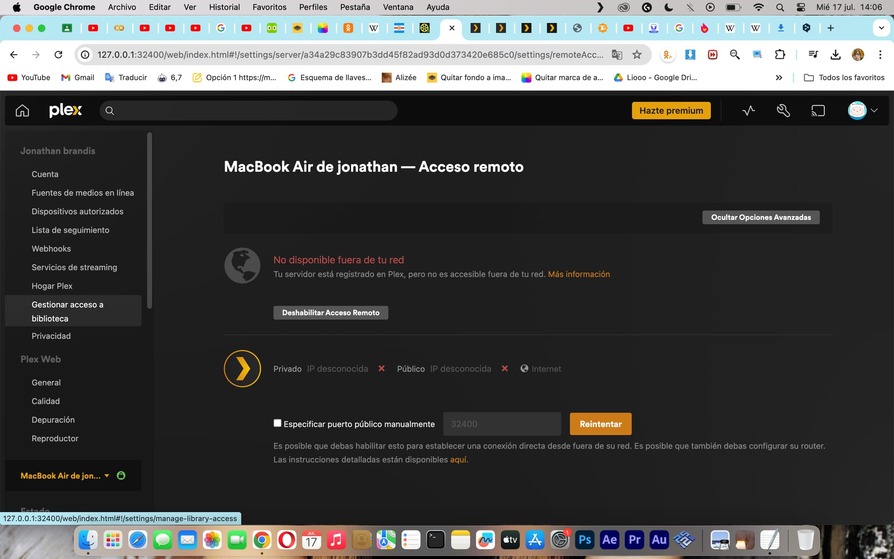

PRIMER PROBLEMA CON MI WIFI

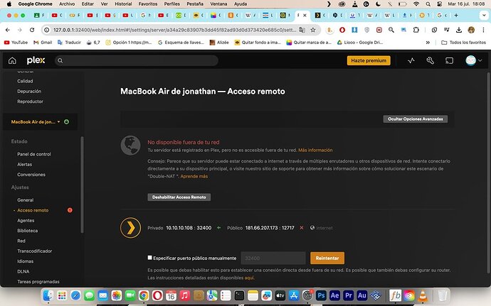

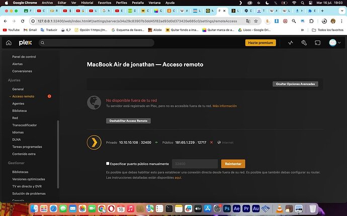

tambien intente probar con otra red de un familiar y me aparece esto:
AYUDA POR FAVOR !!!
Help! I can not enter plex remote access I get a message unavailable, previously if I could see my videos on the tv and I have shared to two people nothing more :(, how can I get back to have the green check for remote access. Here are two images of the problem one is with my wifi internet and the other with a family member’s wifi internet. Thank you I look forward to your response!!! ![]()

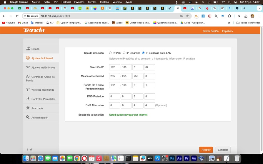

Based on the screenshots you DM’d…
For starters, your ISP doesn’t seem to give you a publicly routable IP address. In order to save some rare publicly routable IP addresses, they treat their backbone like a private / home network (your router’s WAN / public IP address starting with 192.186.x.x is a home network IP address). For comparison – your actual home network is in 10.10.x.x, which is also a private network IP range.
Even if you setup a port forward on your router, that’s not accessible from outside your home network. If you open a site like canyouseeme.org, you’ll notice that the public IP they see isn’t the one of your router.
Your best shot is to contact your ISP and ask them if they can give you a “publicly routable IPv4 address”. To be precise… they might ask you to order a “static IP address” – that’s not technically necessary (though some ISPs insist and want you to pay extra for that).

Another scenario – if this isn’t a recent change by your ISP – they might also have changed their DNS. Your router is pointing to a “domain name server” at an address of your ISP (192.186.0.1) – that means your internet connection depends on “their address book”. They might have used a reference that allowed for your clients / server to establish a relayed connection (indirect connection, where the traffic isn’t going from server → app but server → Plex relay → client). You could try to switch to a different DNS (e.g. Google’s 8.8.8.8 or 8.8.4.4).
