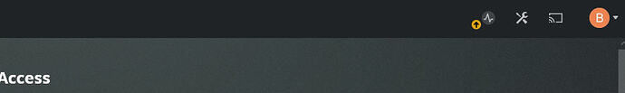

I have two Plex Media Servers. Both accessible via remote access.
Plex 1 is a Synology DS918+ and was my main server for several years. Plex 2 is its replacement, an i5 based system running Ubuntu that NFS mounts the media on the DS918. I just finished migrating friends & family to the new server. Plex 1 will remain as a test system and emergency backup if the new server takes a dive.
Port forwarding statements in my Asus router:
Plex Media Server #2 Remote Access Configuration:
Screenshot (1239)
