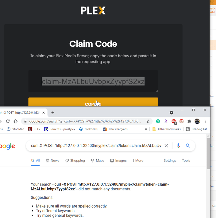

How can i reclaim my server?image

Sorry too late, i remove and reinstalled. Is there a way to reclaim my original server?
reclaiming your server takes a few steps.
  1. Stop PMS
  2. Using SSH or the PlexData share, remove your user credentials from Preferences.xml (entire keyword="value" pair)
    a. PlexOnlineUsername=“value”
    b. PlexOnlineEmail=“value”
    c. PlexOnlineToken=“value”
    d. PlexOnlineHome=“value” (this may or may not exist)
  3. SSH into the NAS
  4. Start PMS
  5. In a separate browser window, https://plex.tv/claim
  6. Copy the claim token it gives you.
  7. Construct the following command line
curl -X POST 'http://127.0.0.1:32400/myplex/claim?token=PASTE-TOKEN-HERE'
( Be careful of quotes )
  1. it will look like:
curl -X POST 'http://127.0.0.1:32400/myplex/claim?token=claim-asdjhfasdfjhgasf'
  1. You have 5 minutes from when you request the claim token so don’t delay.
  2. When you hit ENTER for the CURL command, it will sit there a moment. PMS and Plex.tv are syncronizing with each other again.
  3. When it’s done, It will print out a bunch of user flags and your credentials.
not working
i guess I will start from scratch with same name
you didn’t do that right.
the CURL call is done on the SSH command line as I stated above.
sorry i am not familiar with that part
