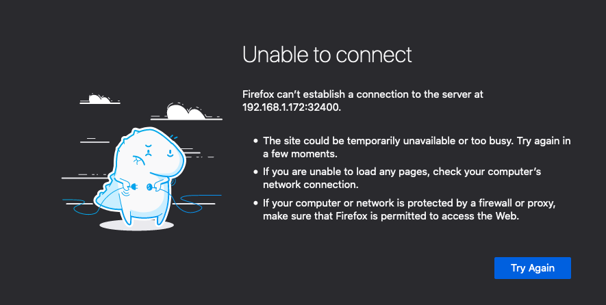

Trying to connect to Plex thru my QNAP after doing firmare update to version 1.20 and now I cant get anything. Worked fine before update. Can I downgrade to previous version??

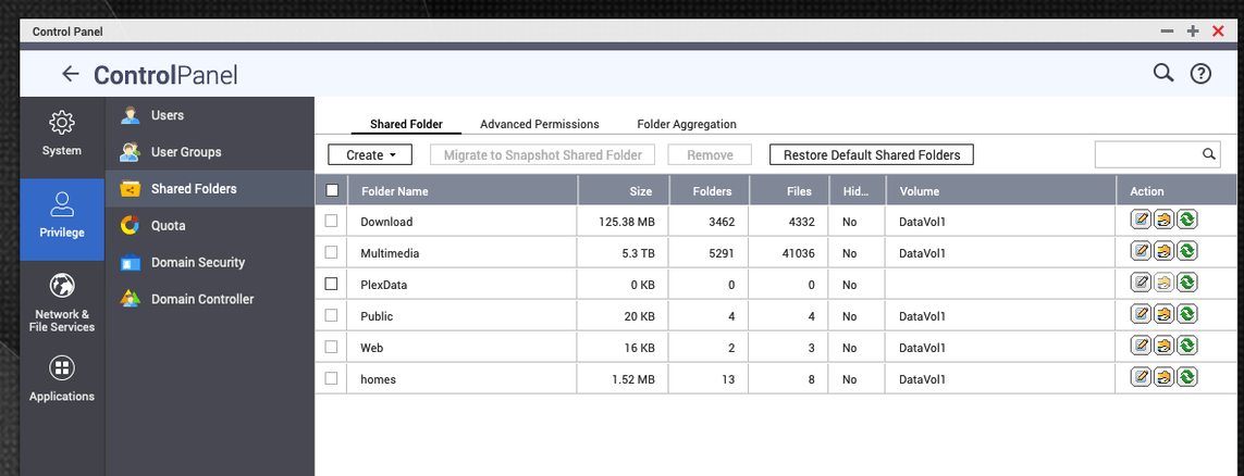

Where do I see Shared Permissions Page? I see this…
This is the error I get when trying to open Plex thru NAS, or when I go on Plex website and Launch it, same thing.
Hover over the middle button, a tool tip shows “Edit Shared Folder permissions”
Ok did that, I went into File Station but I dont see Plex Data listed anywhere there
