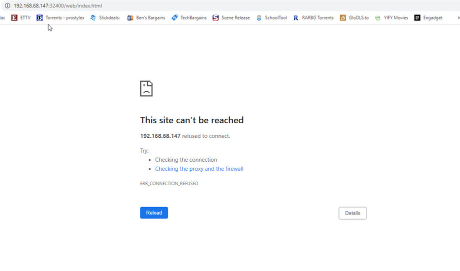

After I updated my Plex server to Version 1.22.2.4282 it runs for a while then it stop
Server Version#: 1.22.2.4282
Player Version#: 4.54.5
Please was working fine until this last update. Now When I reboot my QNAP TS-453be Version 4.5.2.1594 or stop and start Plex, it works for a few, then when I check again later, I am not able to connect or view movies. I am reinstalling the same version again.

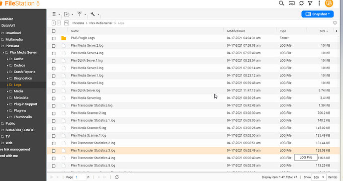

Please do the following:
  1. Control Panel - Shared Folders
  2. Create a Shared Folder, anywhere you want, named PlexData (exact as written)
  3. It will only contain 1 file so do not worry about space
  4. Restart Plex
  5. Let it run 1-2 minutes then stop
  6. Open File Station
  7. Navigate to the “PlexData” shared folder
  8. See, and click into “Plex Media Server”
  9. Right-click “Logs”
  10. Create a ZIP file of the “Logs” directory
  11. Download that from the QNAP and attach it here please.

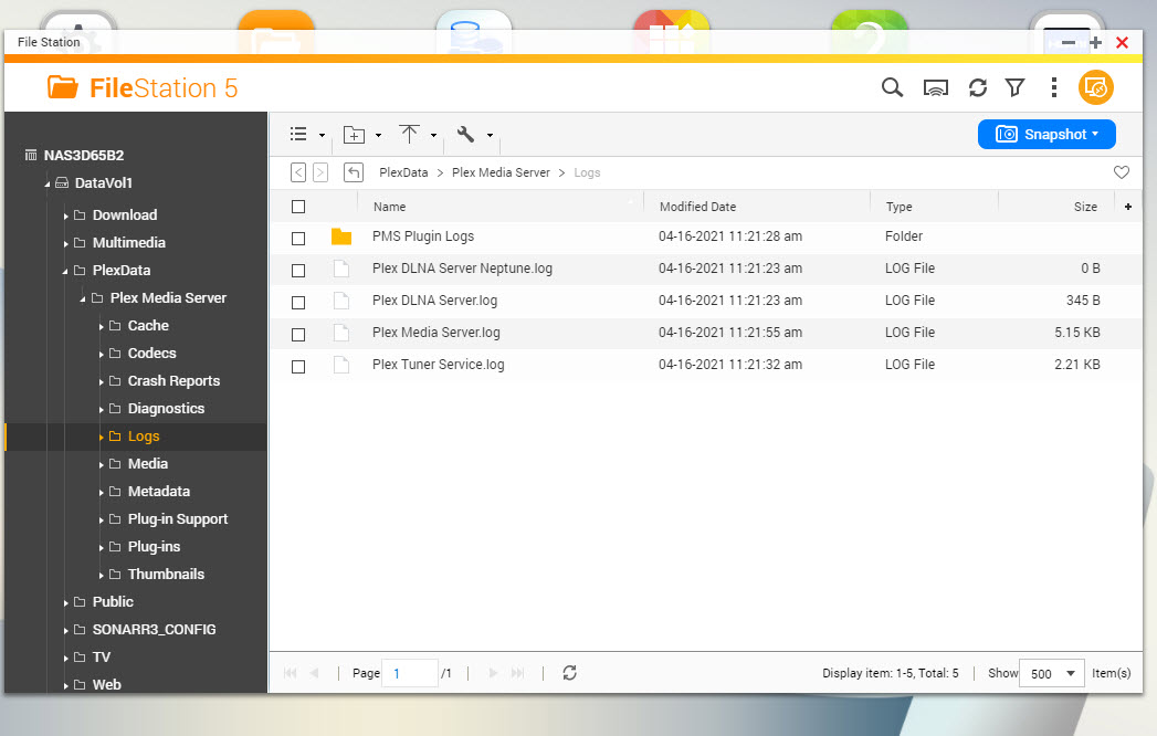

Just tried to do a log but it’s not working, debugging is turned on and the folder has read write permission, I’ll look into it a bit more and post a log when I get it working.
HI Debug is and was onLogs.zip (51.8 KB)
Let me know if this helps
No, it’s not

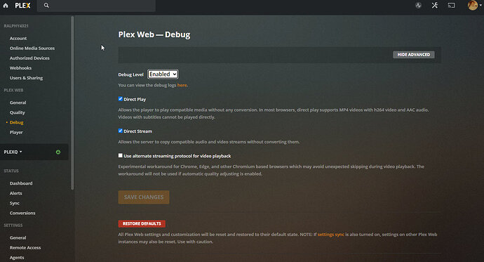

You forgot to click “SAVE” ?
HI Chuck, Maybe debugging is not working, I have disabled and enabled again and clicked on saved as well. See screenshot, I also let plex stay open to collect any logsdownload_2021-04-16_15-35-12.zip (362.2 KB)
Hope this helps
Wrong DEBUG :slight_smile:
Settings - SERVER - GENERAL - Show Advanced – DEBUG logging
That one. The one you turned off :slight_smile:
OK. Please check this onedownload_2021-04-16_17-07-35.zip (29.6 MB)
Those are the ones! :smiley:
