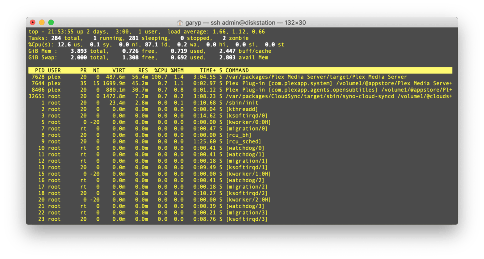

The statement about single thread running : I have seen this. Should you wish to pursue further,
I would like to see a fresh start, with only DEBUG logs, captured when you see it jump up to 100% CPU so I can backtrack the activity.
Thanks for the feedback Chuck, but I have to take issue with that. I’m a Linux sysadmin as part of my job and know how to monitor a server. The system is being monitored via SNMP (both the OS and the integrated lights out (iLO) card in the system) using LibreNMS. As soon as 1.14.1.5488 was installed I saw one CPU core become permanently utilised at ~100%. The ‘top’ utility indicated this to be down to a “Plex media server” process. The high CPU utilisation was accompanied by a corresponding (and completely understandable) increase in thermal output from CPU, VRM and also RAM (suggesting lots of RAM access via the northbridge chipset). Stopping the Plex service saw CPU utilisation (and temperatures) drop to normal levels, restarting the service brought it straight back. Moving to the 1.15 Plex builds did not change the situation. Regressing the Plex install to 1.14.0 shows no high CPU utilisation and no corresponding increased thermal output. It is a bug in the 1.14.1.5488 build, simple as that. And, judging by other threads in this forum, it’s not limited to the Synology builds.

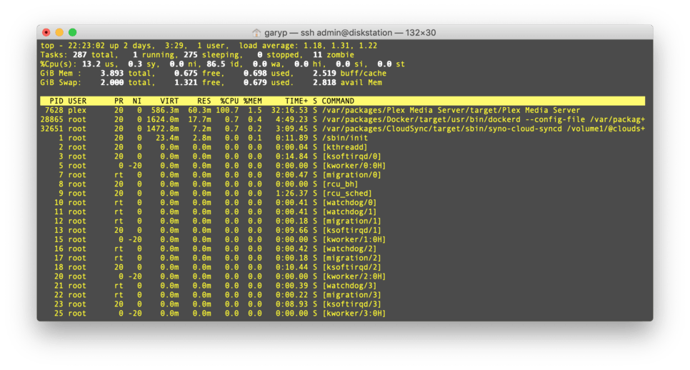

25% of total CPU utilization on an Intel Pentium N3710 processor is not leaving much room for other demanding processes :slight_smile:

I haven’t tried what you suggested, but I just ran “top” on the Nvidia SHIELD TV adb shell, and the Plex Media Server process is stuck at full throttle on there too.
That would explain why it seemed to struggle so much for the past month now…
EDIT : To be clear, I’m running 2 Plex Media Servers on the same network, but on separate devices. Both devices (Synology NAS + Nvidia SHIELD TV) are showing the same single core 100% CPU utilization.

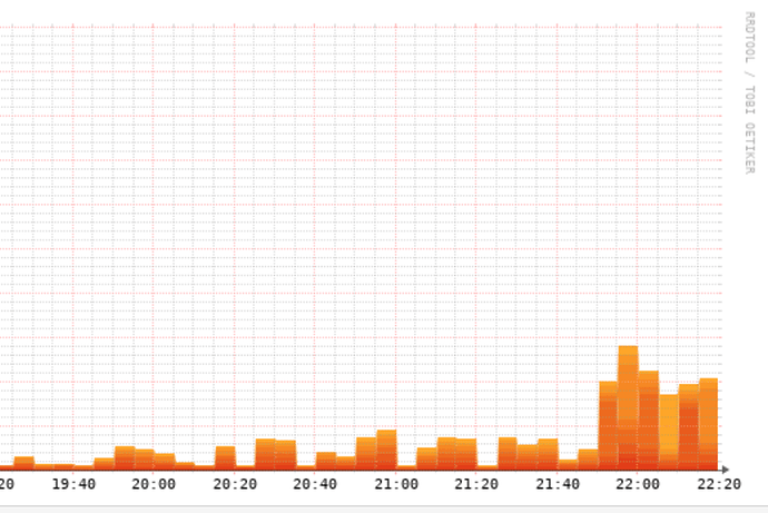

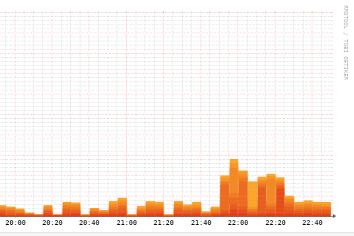

I unfortunately had to rebuild my monitoring system today and lost all my historical data, but I have about 6hrs of data showing very low CPU usage with Plex running (and I’ve been watching a 4k movie during that time). I’m going to turn on all the debugging, upgrade to 5488 again, get some stats of it running the CPU high, then turn off UPnP and see if there’s any impact. I’ll report back soon, hopefully!
I’m still gathering data, but spoilers: turning off UPnP on the router seems to have sorted it! :sunglasses:
Here we go, then:
21:50 updated to 5488, CPU straight up to ~12% (8-core system, so 1 core maxed out)
22:23 running at 12% CPU for half an hour, one core at 100%
22:25 stopped UPnP services on router, no change
22:28 restarted Plex service, CPU drops back down
by 23:00 I’d had half an hour of much lower CPU usage again, although notably not back down all the way to the idling state I was seeing on 5470, but much better
I’ll be leaving UPnP turned off for now, I only had it on because I’m lazy. Xbox owners, though, require it I believe, so this won’t be a solution for everyone. It very much looks like there’s some weirdness in 5488 and later builds with how it handles UPnP, even when the Plex server is told not to use UPnP and rely on manual port forwarding.
