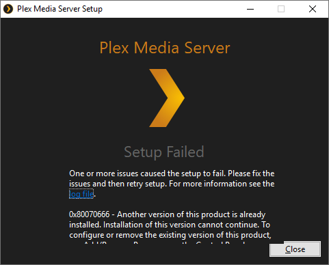

Reinstall or uninstall and reinstall don’t work.
After rollback to version 1.13.9.5466 everything goes normal

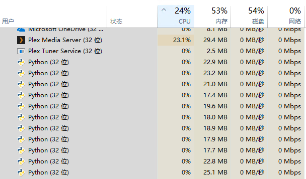

You can look for the Plex processes in Task Manager (Plex Media Scanner, Plex Transcoder, etc). See which ones are using CPU, memory, etc.
I checked the Task Manager.Only the Plex Media Server process is using CPU
