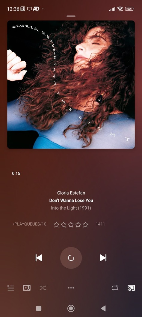

I do playback using plexamp to chromecast. First it said PCM, but the quality was not very good. It said PCM when in reality it was AIFF. Sound logical. But, then this happens, and the sound quality is outstanding . See picture for the details. It somehow switched to this while playing the artist radio. Does someone have a clue how this happend? I will see if I can upload the logs later. It is very good now. But I assume it is a error that turns out to be very good.
