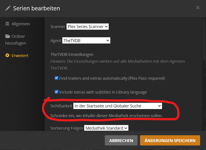

Als erstes: wenn du die beiden betreffenden Mediatheken bearbeitest, sind beide so eingestellt?
ja.

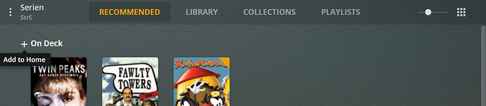

Click on the name of the library in the left side bar.
Go to the “Recommended” tab.
Add the On Deck section by moving your mouse over the indicated spot and click on the +
Repeat if necessary with the other library.
