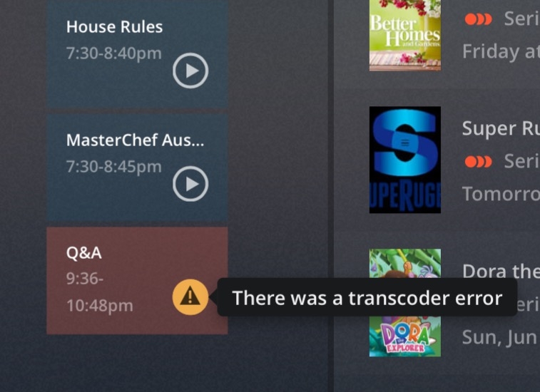

Do you guys have any issues recording ABC in melbourne since the update?
I get a transcode error when recording only the ABC channels!
All other channels are fine and I can view them all Live including ABC. Just have issues recording it.

@discosrule Do you have the same problem with ABC HD, or only on ABC? I recorded that exact episode tonight from ABC HD with no issues. :thinking-face:

Both. And abc2 as well.

Fine, as I can play any Of the ABC channels, live, thru plex. Just doesn’t record. Was also fine recording on v1.54
@discosrule At the expense of being cliché, try a server restart? If that doesn’t work, could you generate a sample from the recording, and shoot it over, alongside some logs?

Logs are over here if interested. As mentioned, the recording doesn’t even start, comes up with a transcode error. This only happens on one set of channels (ABC/ABC HD/ABC2) and I can PLAY all of these LIVE thru Plex, only has happened since the update.

@discosrule It’s a bit hard to follow in there. Can you turn off Verbose logging, and then reproduce? Those errors you mentioned at the start, I think they’re pretty standard as Plex tunes in, the same way you see a bit of a flicker as you change channels on TV normally.
@DaveBinM sorry about that, had forgotten to turn that off. Here you go, just run it again, should be right at the end of the logs.
@discosrule Okay, I might need a sample of this.

It does it with ALL the ABC channels all the time, ALL other channels, 7,9,10,SBS are fine and no issues.
Live TV thru Plex is fine, even plays ALL ABC channels fine live, just has an issue recording it. tvHeadend will record ABC fine as well and the sample file you requested here using curl is fine as well.
1-8. steps, done.
New logs attached, you will see (summary below), that it starts and then kills it after a second, so I can’t get a sample recording from plex.
Jun 06, 2017 09:23:28.195 [0x7f3176bfd700] DEBUG - DVR:Grabber: Going to record for 2492 seconds, final URL is http://matthew:matthew@192.168.4.5:9981/stream/channel/27e8e8ab21ec213ea81ba9b0f6ea8ed5?weight=300?transcode=none
