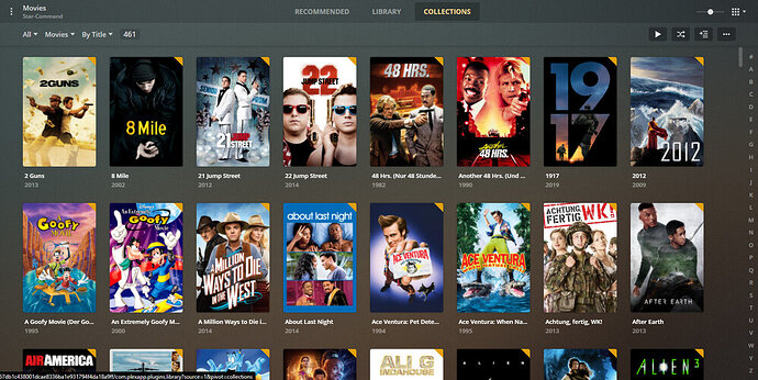

I painfully added a bunch of movies to different collections.
Since I restarted my server I have the following sensation:
It shows all my movies 1:1 in the collections tab as it does in my library…?
But on my phone the collections are still there…?
I don’t get it. Why does it not show the collections on my computer?
Any ideas?
Edit: I have a test account and if I log in with that account the collections show correctly.
So it’s only with my main account. And it doesn’t matter where and how I log into that account. In Collections it just shows me all my movies.

Definitely odd… you’re still seeing the filter options under Collections so it’s like the entire panel isn’t loading correctly for you.
