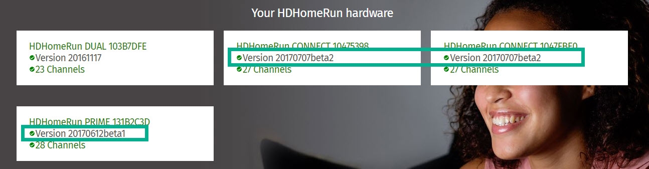

It appears folks here are confusing the difference between the HDHomeRun Software and the Firmware.
If you look at the firmware change log you will see there hasn’t been a new firmware update since 2016…
What you are downloading is the latest software/drivers… but if you look at the status of your tuners you will see your firmware is still the 2016 version. Although some of the HDHomeRun software downloads do update the firmware version as well that is not always the case (look at the software change log to see what I mean). After installing the beta software version my tuner status still shows the same 2016 firmware and says it is up to date. Only the software version was updated.
You might be downloading the latest software but it also installs the beta firmware.
The beta Software does install new (beta) firmware. As the HD Homerun software will include dvr features, the firmware ist also updated for this purpose apparently. But for my HD Homerun Expand the beta 2 software still installed beta 1 of the firmware. This seems to be the latest version.
Well I wish mine would update… mine updated the software version to the beta version but left the firmware version the same and it says ā€œUp to Dateā€ under firmware.
Maybe I’m missing a step…
