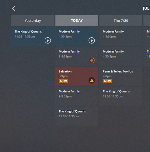

I’m running a headless Ubuntu Server 16.04.2 LTS with a Hauppauge WinTV Quad HD PCIe Tuner.
Just checked my recordings and saw a recording failed with “An unknown error occurred”.
I’ve checked my signal strength and they looked perfect.
Log file is attached. Any insight would be appreciated.
Also once Modern Family stopped recording, Salvation started recording without any intervention. Don’t know what that is about, since there should be four tuners to choose from…
Follow Up:
Ok, I ran four different recordings at 9:00 pm central time and Roseanne initially showed the same yellow triangle with “an unknown error occurred” Other three recordings appeared to be fine. Once my post processing job finished from Salvation, Roseanne started recording…
