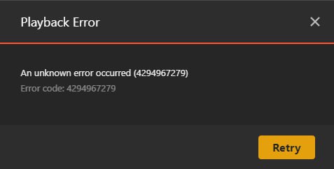

Now the issue I’m seeing as I was stress testing the server, is that with the Plex on Mac I get this popup error a lot if I force a transcode quality:
An unknown error occurred (4294967283)
If I don’t do anything, don’t press Retry it eventually starts playing but direct playing. Then I force transcoding again and then it works. Or sometimes it shows up again and I have to do it again and then it works until the end of the entire movie.

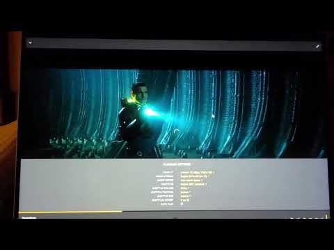

But in the meantime here’s a friend streaming @ 1080p 20Mbps. When she changes to 12Mbps then this happens:
Error msg doesn’t pop-up but same behaviour. It’s almost as if it’s disengaging transcoding. You can see it plays 1-2 seconds, probably the leftover transcoded chunks but disengages the gpu transcoding then quits.

Was just testing this out again but on a chrome browser and got this:
Again, after pressing Retry it works. But for some users it just quits the video.
Can you DM me a sample of a video that is displaying this issue?
This happens on every single video
I can send you a sample, but it doesn’t matter if it’s a 4K 80Mbps remux or a 1080p 30Mbps file. This screenshot is from a 1080p 28Mbps. It doesn’t really matter what it is. As soon as I select to transcode this happens. One needs to press retry for it to work.

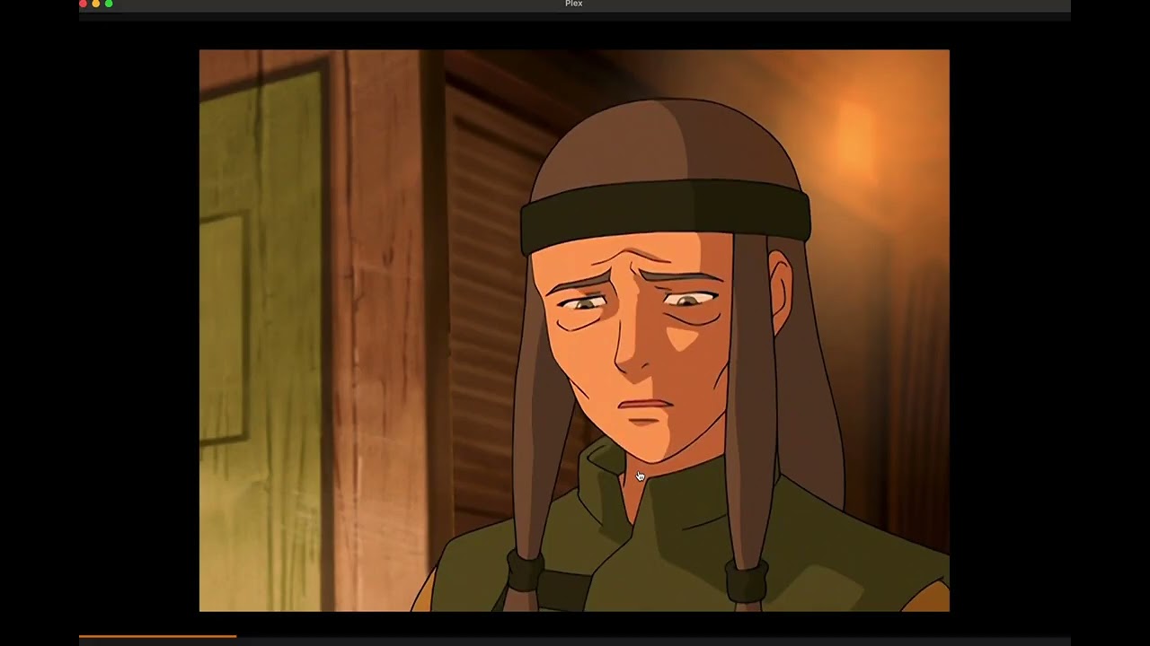

Another quick video showing it in action:
