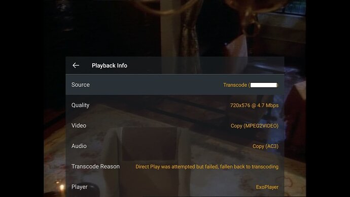

When I look at the playback info I see a message that says Direct play failed, fallen back to Transcoding.

Edit 3: Just tested my Shield 2017 which is hooked up to a TV that didn’t support AC3 5.1 do audio has to transcode the files are playing back as they should.
Playback info is listed as Transcode, audio is listed as Copy.

Screenshot of what I see in Episode detail
