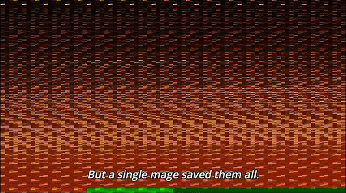

Anime showing up blocky and pixelated
I have noticed this a few times on mostly anime on my server, but I am getting anime that is blocky and pixelated. Totally unwatchable. Source file works just fine. I have deleted it from the share, and then re-scanned Plex to make it disappear, then added it back and then scanned again. Tried it again and it still is the same result. I am at a loss right now.
It is a known ApolloLake issue with the driver from Intel.
Below is a work around which will need be repeated if PMS is updated prior to fix.
SSH into the synology. (Control Panel - Terminal & SNMP - Enable ssh)
Once there
sudo -su root
cd "/var/packages/Plex Media Server/target/lib/dri"
rm iHD_drv_video.so
ls -la
the last command confirms it’s been deleted.
Now restart PMS>

Pretty sure that fixed it. I tried it again after the reboot and good to go. Is this something that gets replaced or something I need to do regularly? Is this file generated in some way?
The driver is distributed with the package.
If you update PMS, and it’s not yet fixed, you’ll need delete the iHD driver again.
What this workaround does is remove the iHD and allow PMS to fall back to the i965
