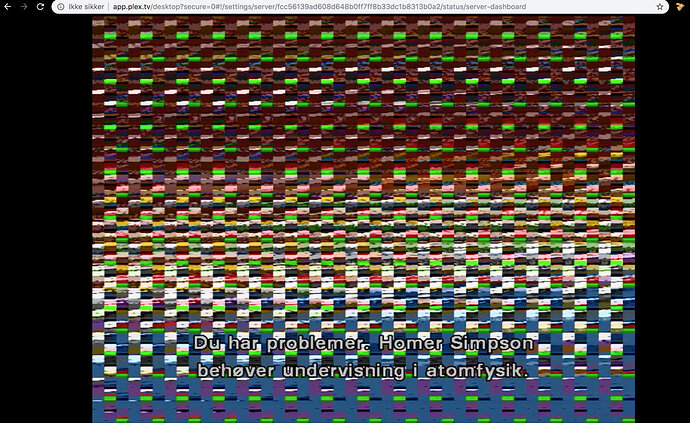

Hi everyone.
I’ve been having this problem where the image is totally wrong when ever I enable subtitles.
It’s happing on my Macbook, iPhone and Nvidia Shield. I’m a plex pass user.
The server is running on version 1.18.2.2058 on a Synology DS418+.
Do anyone have a answer to why this is happening?
Best regards
Kasper
Looks like the Intel driver issue with hardware accelerated transcoding.

Before removing the file, suggest you disable hardware acceleration to test that you have the same problem.
Also, instead of deleting the file, change the name to iHD_drv_video.old or similar, so you can change it back if needed. Otherwise, you’ll have to reinstall PMS to replace it.
You’ll need root privileges, so you’ll need to use sudo rm .... and the administrative password (on Synology, same or similar on other platforms).
As mentioned in other threads, the problem is with the Intel supplied driver. Plex is working with Intel to fix things, including, it seems, performing much of the work themselves, instead of waiting on Intel to fix everything.
Hi there.
I’ve disabled the hardware acceleration and the problem went away. I deleted the file as you suggested and now everything seems to be working.
Thanks a lot!
