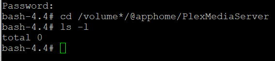

  6. cd /volume*/@apphome/PlexMediaServer
  7. ls -l (list the contents of the folder)
  8. Is there anything in the folder? If so, please paste the listing into the thread, supply a screenshot, etc.

Hi @FordGuy61 - followed all steps and came back as “total 0”
Screenshot 2023-01-04 123558
Thanks for the reply. Plex Media Server is removed from your system.
