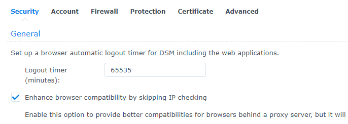

Go to Control Panel - Security - Increase the DSM idle timeout to 65535 and save that.
(that’s the problem)

I have no changed this in security and logged in again.

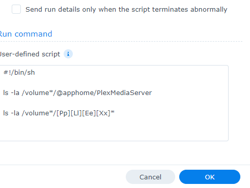

no problem. stand by a moment while I write up a quick script to survey the system .
You will run this as a Scheduled Task - User Script - run as root and have it email you the results.
Script to run
#!/bin/sh
ls -la /volume*/@apphome/PlexMediaServer
ls -la /volume*/[Pp][Ll][Ee][Xx]*
The first should be an error or empty.
The second will tell us what’s going on.
I tried to create a scheduled task but nothing happens.
Did you get the email return?
