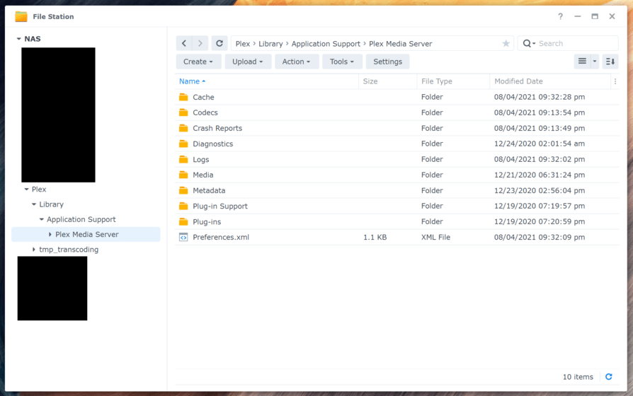

My Plex folder is located in volume 2. See attached folder/subfolder structure.

  1. There is no software in the Plex share. That’s all data (your server’s metadata)

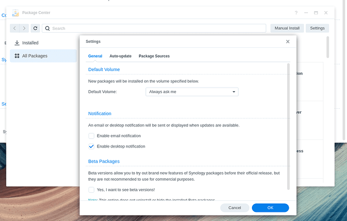

  2. You forgot to select the installation volume (volume 2) for the package -or- you have the default set for volume 1. “Always ask me” is best.

  2. Correct the package center Settings.
  3. Install again and select Volume2 as the installation volume.

  1. Is your metadata still there? (Library/Application Support/Plex Media Server exists)

A1. Yes the “Plex” Shared Folder has the Metadata folder still there.

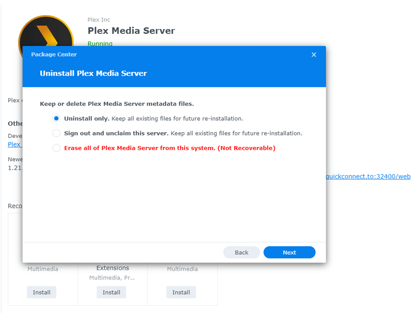

  1. Uninstall Plex - select the ERASE option while uninstalling to remove the rogue DSM 7 installation data

Please confirm to select the highlighted uninstall “Uninstall Only”?

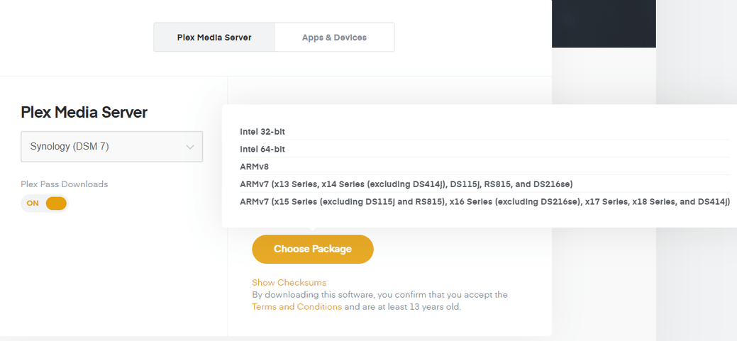

Chuck my next question, which might be why I have the issue in the first place, which of the following 5 packages do I manually install?
Which Synology model do you have ?
If you look here, you’ll find your NAS and the CPU type.
I have a Synology DS1517+
I recall doing a manual install with the ARM V7 last time.
Also please confirm to uninstall using the highlighted “Uninstall Only” in my message above?
@The-Dons
When your metadata is in the Plex share, waiting to migrate, you want ERASE.
Erase removes (clears out) any existing DSM 7 data so a clean migration can occur.
Chuck please confirm the following option,
meaning all exisitng files will be deleted including the “Metadata” files?
Allow me to clarify
  1. I NEVER touch media
  2. Erase ONLY removes the Plex metadata which is in a DSM 7 structure. It NEVER erases DSM 6 data.
  3. When installation occurs, after migration, you DSM 6 data will be moved to DSM 7 structure. (If you erase after migrating – THEN you will lose your metadata)
