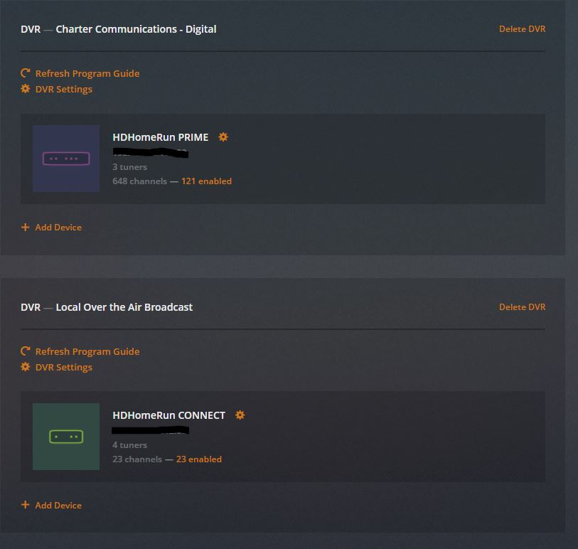

I did also look into the thread here about using curl to make two DVR’s manually which I did this successfully and this would be optimal imho since they both then have their own EPG and no channel mapping is needed.

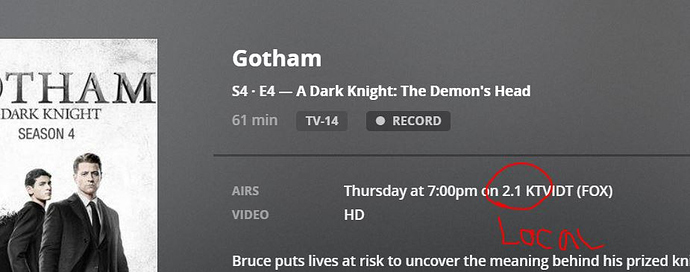

However the DVR containing just the Quatro is unable to pick the OTA channels. Meaning if I pick a show from the Program Guide (the one the Quatro is using), then select a show from a supported channel it can tune, I can see the show should be on OTA 2.1 or whatever channel

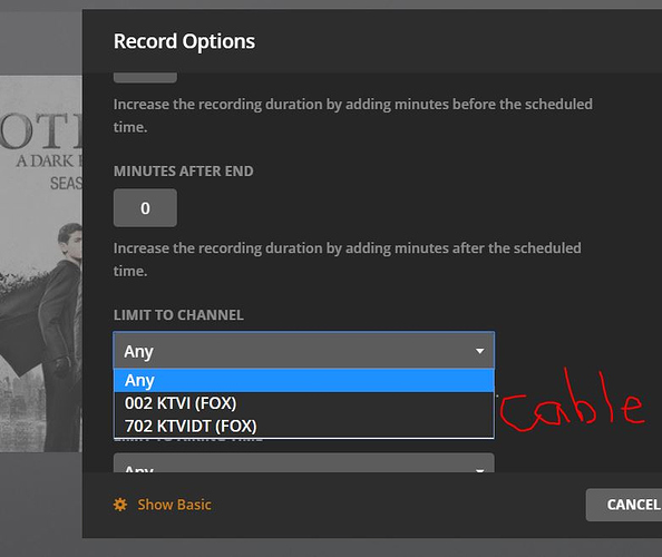

but if I go to Modify Recording to force the channel for 2.1 for instance the only choices are those of the DVR the Prime is in.
Leaving it on “Any” once again allows the scheduled recording to use the Prime if it finds the show there on any channel.
