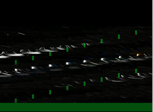

Just in case any Intel and/or Plex folks (whoever can sort it out, I guess) are browsing this thread, another error I found is that hardware encoding+decoding+HDR tone mapping produces the following beauty:
Similar to the error documented here in March, but it only occurs when all three settings above are enabled.
