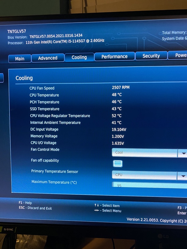

Updated bios to 0054. (seems I was one version behind)
Set fan profile to cool (this should be better than balanced)
Disabled turn fan off option. (Even better)
Started 6 streams all transcoded down to 1Mbps. Some looked OK other had artifacts, this does depend on what the source is but that is another issue..
System ran at 44C, temp never went any higher than that. Bios screen shot was prior to applying the cool setting. Likely the reason I see cooler in OS than in bios.
Finally crash happened, I saw all cores max and the system stopped responding.
Syslog shows [drm] resetting vcs1 for preemptive time out. Same as before.
NUC is still cool to the touch, and cool air coming out of it.
Sad times!
Photo showing bios, it ran cooler once the OS was loaded.
I wonder if there is some chipset component involved in transcoding that is heating up that isn’t cooled and/or monitored by a temp sensor?
You said it was cool to the touch but heat localized in some small component might not be felt on the chassis with air flowing through. Can you install HWinfo and see if something is heating up?
And what is that ‘Max Temp’ set to 95 at the bottom? Is that a setting you can lower to see if the system shuts down?
I personally don’t think it anything to do with temp.
It’s the drivers, already documented some of in my previous posts. It’s a very new chip, only comment on the intel Neo GitHub is that it was working on one kernel version and working does not mean stable.
Max temp is just the setting for the bios to throttle back the cpu if it gets too hot., it did not even see 50C so that option isn’t even in play.
Not running windows, but sensors are detected and I was watching temps in one place and syslog in another until the system crashes.
