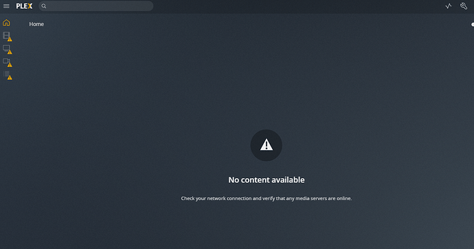

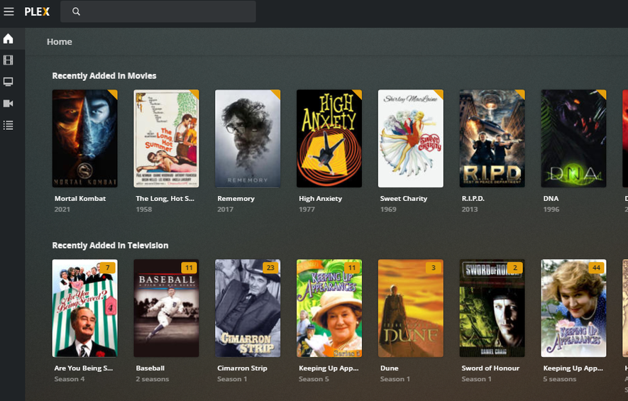

So… they why is it not working? First image is via IP… second image is app.plex.tv
Server is running 1.23.4.4805
IP is running v4.57.4
App is running v4.61.2
