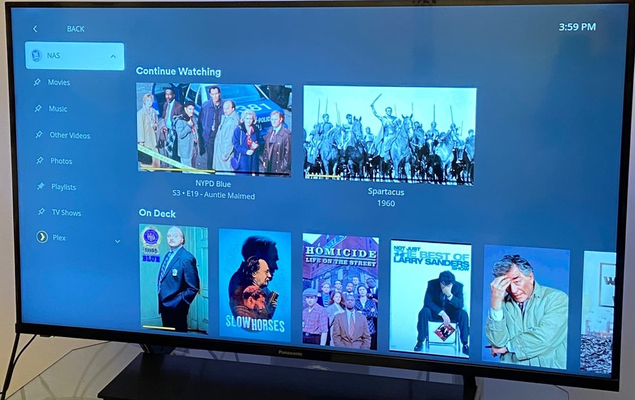

Hello, I seem to have hit a snag. When I start up the Plex app on my Panasinbic TV, instead of displaying what I had been seeing a few weeks ago, I am presented with a different layout to what I usually get. I have to click through a couple of screens to get to that.
This is what I see first:
then have to choose More (i.e. the three dots at the bottom of the list at the left) which leads to the following display:
I’d not previously had ‘Plex’ as an option before. I have deleted the Plex app from my computer, which I would have thought would remove ‘Plex’ as a server option - all my movies and TV are on my NAS.
Choosing NAS leads me to me to my expected screen:
I think I have to somehow hide the ‘access’ to Plex (even though it’s deleted.)
Many thanks
Ben
You simply need to “pin” these media libraries to the side bar again. The Home page follows the side bar.
https://support.plex.tv/articles/customizing-the-apps/
