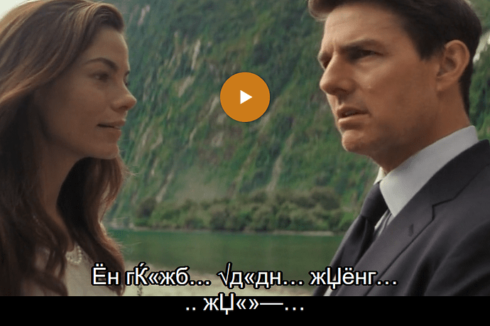

Screenshot_2018-12-22%20Mission%20Impossible%20-%20Fallout|690x459
Arabic subtitles are showed normally on VLC player but not on Plex player on my PC or TV
Is there any pieces of advice??
Regards everyone
Your screenshot didn’t take. Can you try to upload it again? Just drag the picture in the reply window.
Okay… I see. And you say VLC displays them correctly…
I wonder if it has anything to do with the encoding the subs are in. Still though. Why would VLC play them fine.

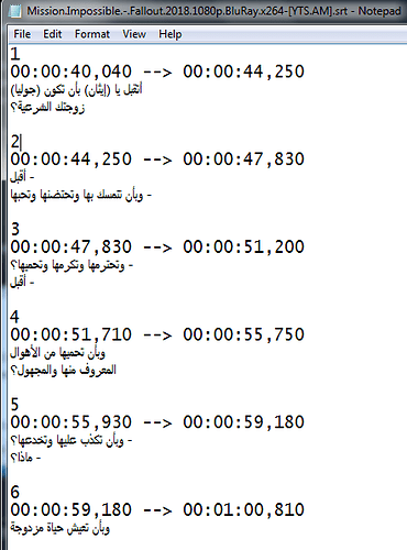

It’s encoded UTF-8 and displays the text correctly within Notepad. Though I don’t know what it says cause I can’t read Arabic.
Here is a quick peek of the contents of the subtitle.
