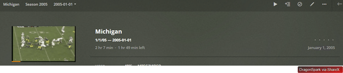

The game takes place on January 1st, 2005. So I have the file saved as such:
\\machine-name\Video\Games\College\Michigan\Season 2004\Michigan - 2005-01-01 - Rose Bowl.mkv
As best as I can tell, I am following the prescribed guidance. However, what I see is this:
You can see that the season says 2005 when it is defined as 2004. Also, I do not see Rose Bowl anywhere, so that would be nice to have as well.
Any pointers/guidance/suggestions to get me in the right direction would be greatly appreciated.

You can add anyway you fell like. Whatever looks good to you. Unfortunately, sports are not allowed on thetvdb site and thus will not match database source(thetvdb). This is not a PLEX thing. This is strictly TheTVDb and they are VERY adamant about it.

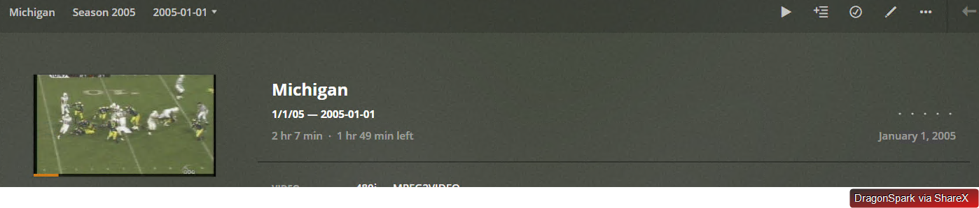

Thanks for your reply and helping out this newbie, @NewPlaza. :slight_smile: I guess my problem is that I do have the title/path named as I would like, and based on the documentation/link above it is following the guidance.
However, it is neither showing Rose Bowl (in the title of the .mvk file as mentioned in the bottom of that article) nor is it showing 2004 (in the path as also suggested by the article) but 2005 for the season.
I have a feeling I am doing something very wrong here so I am looking for further guidance on how to correct this.
That’s assuming you can use thetvdb. That article is on how to best name things so plex can match it up with thetvdb.
Your best bet is to create another library of type OTHER VIDEOS
Or, follow this…
https://support.plex.tv/articles/200265256-naming-home-series-media/
plex does not get episode titles from the file name. It can get it from online metadata or embedded metadata of an MP4. since that is an MKV you would just need to edit the episode title in Plex metadata to add Rose Bowl * (click the pencil on top right)
it showing 2005 instead of 2004 is a bit odd. i am guessing it got it from date on the episode. I have a feeling we have always just done what the TVDB did were if it aires in a year that is the season. and it it taking year in file name as priority. gonna have to ask a folks about it.
anyway maybe just change it to 2004 ( in file name) then edit the metadata “originally available” date of episode in plex to be the correct 2005 date
