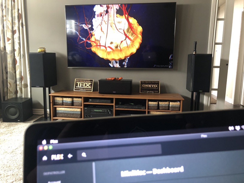

OK, did some testing. All files play without hiccup from a USB 3 drive with an SSD from the shield using VLC player…ATMOS and all.

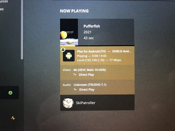

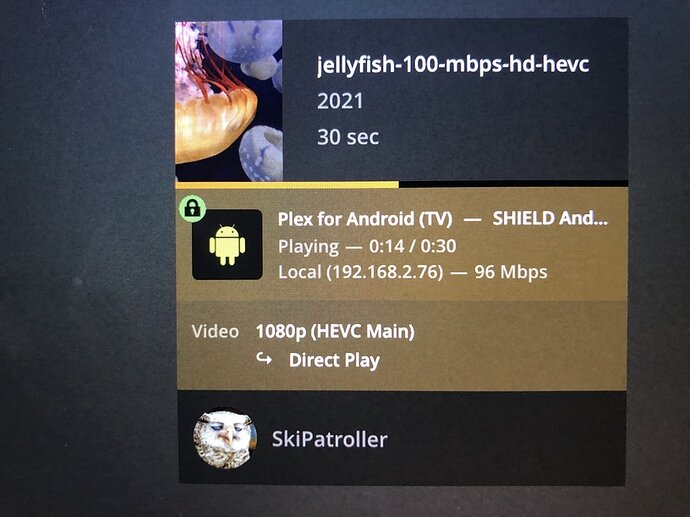

Playing it through Plex is a different story. Those same files still stutter. The dashboard, at its peak, showed 124mps, but playing some of the Dolby files (Leviathan) they showed much less but still stuttered (buffered). I have attached some pics. I’m hoping you may be able to shed some light on where the issue may be.

The 100 and 140mps versions of the Jellyfish video had a buffering issues too.

I think I may have found the culprit. The CAT6 cable that was connected to the Mac mini was only showing 100Mbs. I changed that cable and the network immediately changed to 1Ggbs, see images attached. I tried playing all the demo files and all played without stutter :star_struck: The 140mps Jellyfish also completed with only a short stutter at the beginning. One of the ATMOS demos was playing at 159mbs as shown through the PLEX console and it was fine. Pufferfish played without a burp.
