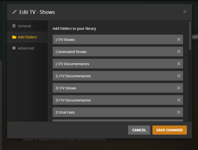

If it’s messed up so bad it’s putting one show inside another one - I’d look at the filepath - all the way back to the root - and what’s added to Add Folders.

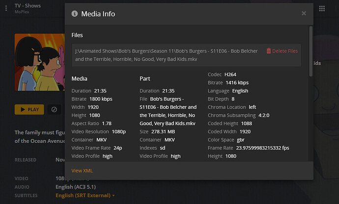

Pull up Get Info (under the dots) for one of the episodes and that may reveal the flaw in the death star…:
J:\Animated Shows
is the folder off the Root containing this batch of TV Shows - and that folder is Added to the Library:
Looking at the Get Info for an episode, it’s showing files attached to one episode. It’s showing Attack on Titan and directly below that it’s showing Megalobox.
