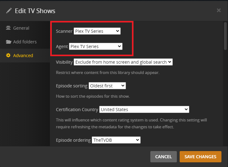

What about
I have 3 hierarchys, /tv, /movies and /music
And what path is set in the properties of your tv shows library, at the “Add Folders” tab?
It’s /tv
You have Plex TV Series for both the scanner and the agent, correct?
If so, I do not know why Plex is not recognizing the show correctly.

Yes the agent and scanner are plex TV Series.
