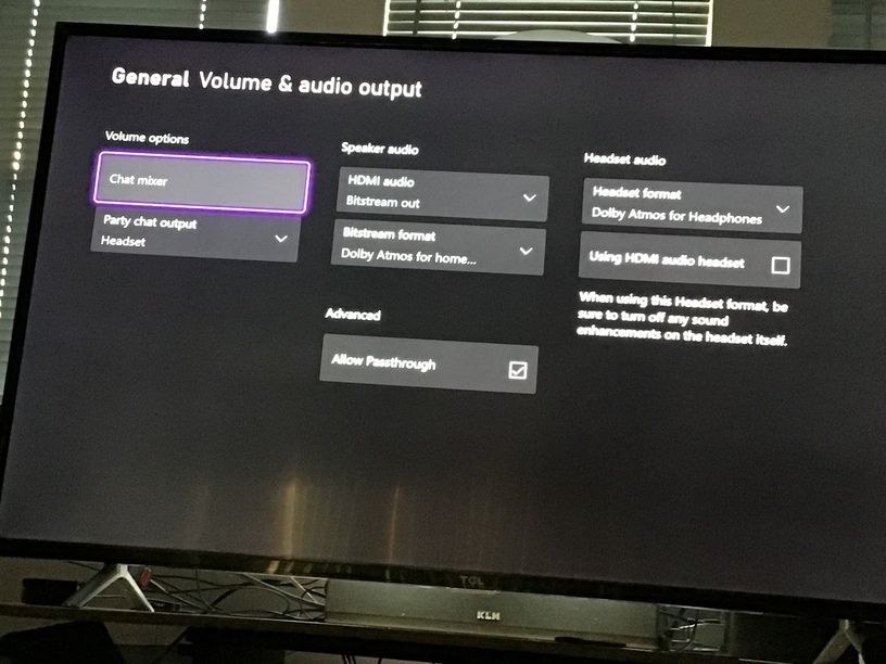

This is the system setting needed.

Xbox audio settings
Speaker audio 5.1 uncompressed
Allow Passthrough is On

7.1 and 5.1 use PCM out, meaning the xbox is decoding locally (not passing through).
AFAIK, enabling the pass through option (see previous image above), allows the APP to pass through (over riding the local xbox decoding) to let the receiver/soundbar handle the audio decoding.

mine is bitstream out (as per my image above), my receiver is a yamaha rxv583 from a few years ago now with 5.1.2 atmos.
