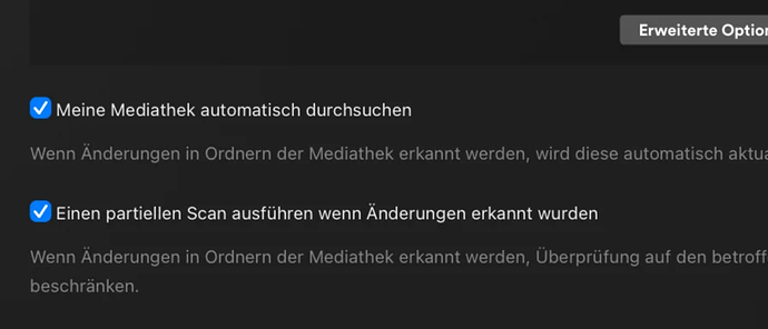

weirdly, the auto-scan function has suddenly stopped working for me. New media are not recognized in the media library. They are only recognized after a manual scan.
The relevant options are activated in Plex.
