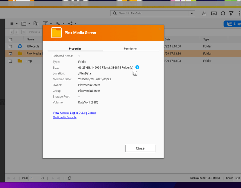

This is what I see
– waiting a while –
It will take time to complete (this is an ARMv8 CPU) but it will be a full ZIP backup of “Plex Media Server” directory.
Backup completed.
1 of 1 items (Plex Media Server) added to ZIP
Size matches
